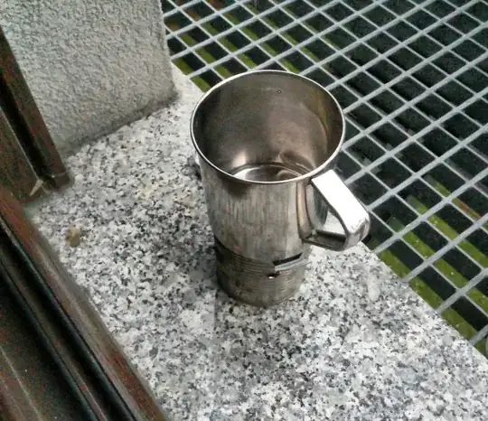

I use a permanent marker to do the traces and etch them in a stainless steel cup, heated with a tea light (small candle.)

This is my setup, the tea light goes in the can under the cup:
Setup
What can be the cause of it coming out so badly?
