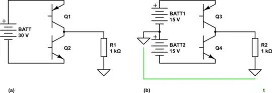

Figure 2. (a) What you are proposing. (b) What is required.
  • In 2(a) there is no return path for R1 so the circuit can't work.
  • In 2(b) there is a return path.
simulate this circuit
*Figure 2. A work-around."
If you are stuck the circuit of Figure 2 should work. Assuming that the device will draw the same current on the positive and negative supplies there is probably little current on the 0 V pin other than the return current from R1. Set R3 to give 20 mA through D1 and you should be OK. Confirm that the voltage between 0 and -15 V is stable at both +700 and -700 V on the input.
