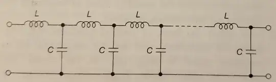

Lumped-element delay line formed with an array of equal-value capacitors and inductors.
I was told that the above circuit is used to delay signal. The time constant per element is t = sqrt(LC). The expression was provided by the book I'm reading, but it did not include how the time constant was derived. Can someone please provide an explanation of how the circuit work and how to derive said expression?
Note: I took a course in electronics 3 years ago, so the more details you can provide, the better.
The expression in the book is based entirely on the distributed inductance and capacitance of a real t-line and so it is accurate, but only to a certain degree. As frequency rises (or rise/fall times shorten) the lumped-element model becomes less realistic.

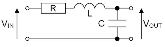

For example if I made a single element LC and chose the ratio of L to C to be 2500, the characteristic impedance would be \$\sqrt{2500}\$ = 50 ohm and so I feed the circuit from a 50 ohm source: -
I can choose R = 50, L = 250 nH and C = 100 pF. I've chosen L and C to be these values because they are broadly what a 1 metre length of 50 ohm coax will be. I get this result: -

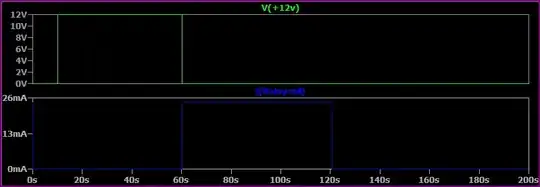

Tool source.
In the lower part of the image is the step response and I've set the cursor to be about 50% of the 1 volt step applied. The time to reach this point is about 6.5 ns. If I did the calculation: -
$$t_D = \sqrt{LC}$$
I get a value of 5 ns. Not a million miles off and hopefully you can see that lumped element lines are not quite what the theory states because they are trying to mimic a real t-line.
    I am actually asking about the analysis of the circuit. Like base on the description of the circuit, it sounds like if I input a V(t) signal on the circuit, then the output should be V(t - tau), where tau = sqrt(LC) for this case. So I was wondering how to arrive at that answer. – ConfusedStudent Jul 07 '18 at 22:25
  • Why not get a free simulator and try it out or ask a more explicit question that I can focus on. – Andy aka Jul 08 '18 at 00:11
