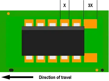

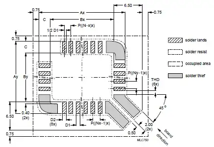

Note that also SMDs can be wave soldered, but then the orientation of the parts is important. Some parts have to be placed perpendicular to the wave direction. Fine pitch parts like 0.4 mm QFPs can't be wave soldered because all the pins will be shorted, but QFPs with a higher pitch can. They need "solder thieves", which are solder pads at the end of a row of pins to gather residual solder.
A QFP may have to be placed at a 45° angle, and will have the solder thieves at one of the corners:
The wave direction is important during PCB layout and panelization, and the production engineer should get clear instructions on it.
