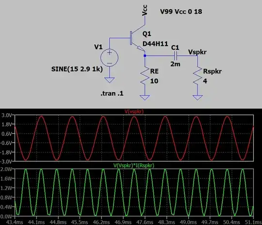

Just did a quick run on the basis of above analysis, except that I didn't bother working out the \$V_\text{BE}\$ for the BJT. I just set the DC bias for the input signal as shown. Close enough.
Spice reports the power in the speaker at \$1.0043\:\text{W}\$ and the RMS voltage across the speaker as \$V_\text{SPKR}=2.0043\:\text{V}_\text{RMS}\$. Not bad for shooting from the hip, so to speak.
Sadly, Spice also reports that the power for the BJT here is about \$3.9\:\text{W}\$ and for \$R_\text{E}\$ is \$20.7\:\text{W}\$. This ignores all the driver stuff that would normally have to back up this output section and would only increase the power dissipation. But in round numbers this means burning off about \$25\:\text{W}\$ in a circuit that will deliver \$1\:\text{W}\$ to the speaker. (Which is a good thing, I suppose, if you own a lot of stock with your local power company. You'll get some of your cost back in dividends.)

Here is an LTspice schematic that can be used to program up and test out any particular crazy-minded class-A amplifier of this kind. I've used a particular BJT in it that can handle some current -- but feel free to change it. Other than that, the specs are hopefully clear. Make some changes and run it.
Aside from setting up the desired power and load values, only one of the two -- either \$R_\text{E}\$ or else V_\text{CC}\$ -- can be set, as the other one is then determined by that choice. So set exactly one of them, not both. The other must be set to zero.
The .ASC file follows here to save time having to write up the above schematic, by hand.
