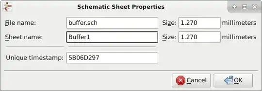

First, create a new one by going to "Place->Hierarchical Sheet". Once you click to place it, you will have the following dialog.
Hierarchical Properties
Here, the important thing is the "File name". This will be common for all of your copies of the buffer. The "Sheet name" will be unique for each copy.
