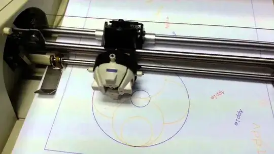

I try to concretize it a bit, by suggesting the idea of building an old school "Plotter" device...something that can roll a sheet of paper forward and back, then has a pen and an arm that can only move on one axis.
If you try to get someone to think about building such a machine, then you can easily get them to think about programming it to draw lines and squares. It's also relatively easy to get them to think about drawing a diamond, when they are moving the paper and pen at the same speed.
Then if they start thinking about what it takes to draw a circle, they have to think about what's different from drawing the diamond. They have to speed up and then slow down the arm's movement, and go the other way.
I feel like making it concrete in this way kind of demystifies the graphs.
