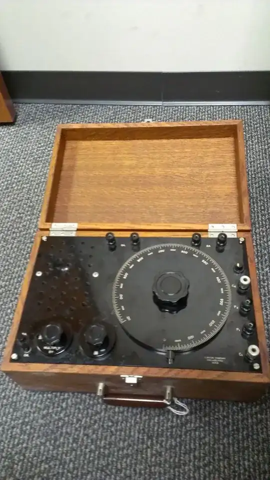

A friend of mine picked this up at a garage sale where an elderly electrical engineer was selling a bunch of old test equipment.
It's missing a faceplate where it should name what it is, and he's googled the company name and model number, all to no avail.
Several of the engineers in my company have been by to take a look at it, and so far the consensus seems to be that it's some sort of tunable filter (it has what appears to be a large variable capacitor and large variable resistor).
I was wondering if anybody here had seen one of these before and had any idea of what it was used for, and possibly some links to relevant documentation.
UPDATE: Added image of interior of device
Wideview Closeup Inside
TehBam
  • 161
  • Whats below the holes on the top left. Speaker? or vent? (Two screws seem to be holding something up) – Doc Aug 10 '12 at 15:10
  • We think it's a vent, under it is a flat strip of metal that snakes back and forth like a radiator. Multiple taps come off the strip and go to the multiply by knob. We think it's some sort of variable resistor. Under the big knob is what looks like a variable capacitor, wikipedia seems to think the construction is called a spiral torsion spring. – TehBam Aug 10 '12 at 15:20
  • I should also mention, it's similarly vented on the bottom in the exact same place – TehBam Aug 10 '12 at 15:23
  • People have been coming into the office all day to take a look at it, and the general feeling seems to have shifted to the large dial being a variable resistance, not capacitance. The thinking is now that the spring we thought was the variable capacitance element is simply the electrical connection for the wiper, with the outer metal band of the large circular piece being the variable resistance element. – TehBam Aug 10 '12 at 16:10
  • Well, after a substantial amount of poking around on the internet and distracting everybody at my company, I think the consensus is that it's some sort of portable wheatstone bridge-esque device, possibly a wein or maxwell-wein bridge. I would still love to hear if anybody knows anything more about this – TehBam Aug 10 '12 at 19:14
    @TehBam - Measure the connections to the big rotary thing with an ohmmeter. That should tell you if it's a cap or a potentiometer. Heck, just measure what you can, and report the resistance or capacitance (if any). – Connor Wolf Aug 11 '12 at 05:55
  • @FakeName We did several resistance measurements on the big rotary portion, and found that the resistance was just a few ohms, and wasn't changed by setting the dial to different positions. It's entirely possible that the multimeter we were using wasn't accurate enough to read the changes if it's supposed to be a very fine potentiometer, but it didn't seem to behave like a variable resistance, we're thinking variable capacitance or inductance is more likely, given how it's connected – TehBam Aug 14 '12 at 14:32
It is precision potentiometer with very low resistance and very high ratio accuracy. It could be used for say in bridge with "zero reading" galvanometer to match 2 currents or voltages. It was possibly marketed for chemical labs doing thermocouples measurements.
I'd estimate it is nearly as good as low-end Kelvin-Varley divider. And can still be very useful and very stable thermally.
One clue comes from googling the "Rubicon Company Philadelhia". There are similar products (from 1960s) like "standard 1 Ohm", potentiometers, galvanometers (with mirror for light beam!) and other high end lab devices of the era.
