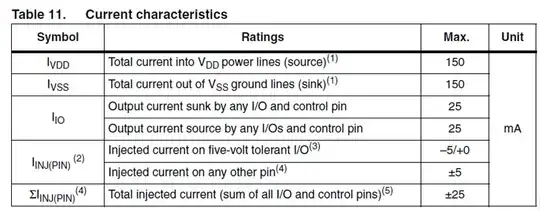

This is what I do with an STM32F:
But different LED and resistor value.
Make sure you keep the current of the LED to below the spec for open drain ports and don't use too many pins in this manner.
