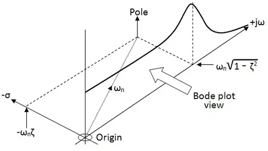

Behind the resonant peak in the bode plot above is lurking a pole but you cannot draw it on the bode plot because neither of the pole's co-ordinates are exactly along the frequency axis.
And together, in 3 dimensions they look like this: -
As you can see, you cannot mark a pole on a bode plot unless it occurs right on the jw axis but, then the bode plot peak would rise to infinity and it doesn't on your bode plot.

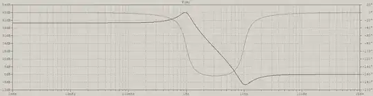

Since you say you understand poels and zeroes, then you understand that they are nothing but roots of the characteristic polynomials of the numerator and denominator, and they don't have to be purely real (s=1), or purely imaginary (s=i), they can be complex (s=-1\$\pm\$i).
In the same manner, the poles and zeroes in your case are complex, which means they are damped, which results in their projection on the j\$\omega\$ axis to not be a peak to infinity, or a valley to zero -- they are damped.
For example, a 2nd order transfer function with a pole at 1Hz, and a zero at 10Hz. The transfer function is:
$$H(s)=\frac{a_2 s^2+a_1 s+a_0}{s^2+b_1 s+b_0}=\frac{s^2+4s+100}{s^2+0.4s+1}$$
and the plot:
plot

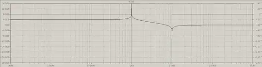

In this case, the roots are z=-2\$\pm\$9.798i and p=-0.2\$\pm\$0.978i. They are not purely real, or purely imaginary, therefore their projection on the frequency axis appears as damped. If the terms b1 and a1 were zero, then the roots would be purely imaginary:
pureimag
Looking at your picture, the transfer function has a second order denominator and a first order numerator, because of the slope after the zero. The pole looks to be slightly underdamped. If I'd try to obtain a similar result, I'd try with b1=1.2, a2=0 (need 1st order), a1=1 and a0=10:
attempt
Notice how the pole peaks very slightly, and the zero is smooth due to the numerator being a 1st order polynomial, thus the root (zero) is purely real. If it were to be a funnel-like magnitude, it would have been a complex pole without a real part, only imaginary. But like this, the slope from the pole until the zero is -40dB/dec, then, after the zero, -20dB/dec. Also look at the phase, how it goes up by 90o.
