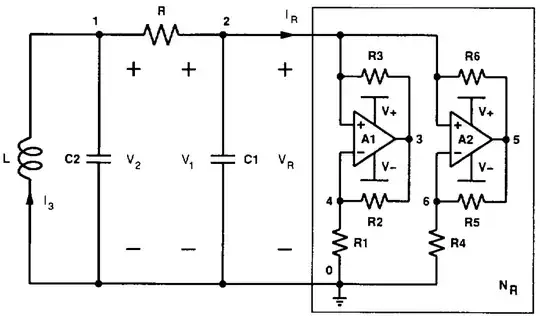

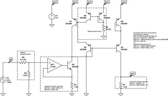

Chua's circuit is one of the simplest circuits known to exhibit chaotic behavior. It consists of resistors, capacitors, an inductor, and an active nonlinear resistor. One implementation of this nonlinear resistor is given in the figure below of Chua's circuit from Kennedy's 1993 paper: enter image description here
I simulated this nonlinear resistor in LTspice...
... and measured its current-voltage (I-V) characteristics by sweeping V (\$V_R\$ in Kennedy's circuit) from \$-5\text{V}\$ to \$+5\text{V}\$ and measuring the current output through V3 (\$I_R\$ in Kennedy's circuit). All component values were chosen to match those in Kennedy's paper. My results are shown below (and match the results reported by Kennedy, not shown):

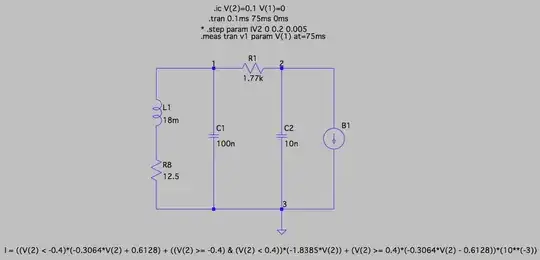

Next, to test that current outputted by my nonlinear resistor still induces chaotic behavior in Chua's circuit, I simulated Chua's circuit in LTspice, replacing the nonlinear resistor with an ideal current source whose output is given by \$V_{out}\$ (defined above) times the gain of \$-0.245\frac{\text{mA}}{\text{mV}}\$ (calculated above). This results in the following piecewise linear formula for \$I_{out}\$:
\$I_{out} = \begin{cases} -0.306V_{in} + 0.613, & V_{in} < -0.4 \\ -1.839V_{in}, & -0.4 \geq V_{in} < 0.4 \\ -0.306V_{in} - 0.613, & V_{in} \geq 0.4 \end{cases}\$
where \$V_{in}\$ is in volts and \$I_{out}\$ is in milliamps. This circuit is shown below, where all component values and initial conditions were chosen to match those in Kennedy's paper (R8 is a necessary parasitic resistor) and the output of the ideal arbitrary current source B1 is given by I = ((V(2) < -0.4)*(-0.3064*V(2) + 0.6128) + ((V(2) >= -0.4) & (V(2) < 0.4))*(-1.8385*V(2)) + (V(2) >= 0.4)*(-0.3064*V(2) - 0.6128))*(10**(-3)) at the bottom of the figure.
The circuit does indeed exhibit chaotic behavior, despite the approximation made to Kennedy's nonlinear resistor:
Thus, we have established that my transformer-based nonlinear resistor has similar I-V characteristics to Kennedy's nonlinear resistor, and with an ideal current source whose output is based on that of my nonlinear resistor, the chaotic nature of Chua's circuit can be replicated.
