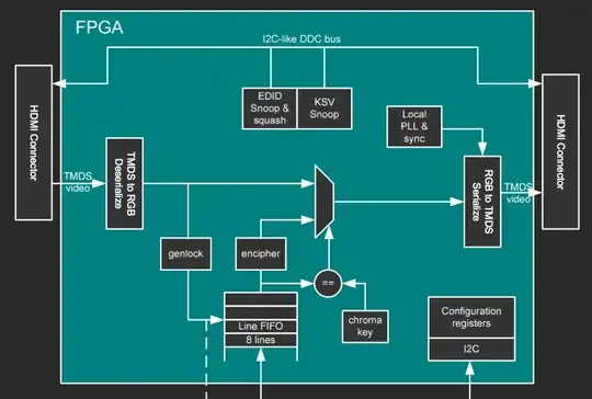

FPGA Block Diagram NeTV Block Diagram
This is a block diagram from one of bunnie's presentation slides.

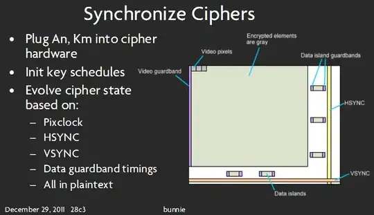

Slide showing HSYNC,VSYNC, PIXCLK
This slide seems to imply that video pixels are, in fact, decoded (not necessarily decrypted).

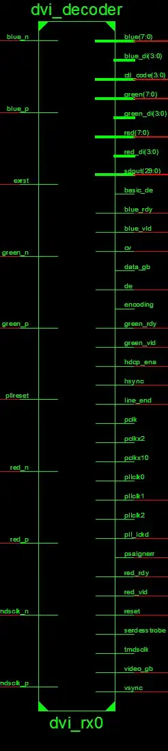

  3. I have investigated the source code as to where I should 'tap into' the video data.
    This looks like the appropriate spot:
    Block Diagram of DVI Decoder
    I know, this image is long - it is the best I could do while making it clear to read. Blame Xilinx's tool for that!
    This seems to take in the TMDS data and output 8-bit for each color.

    The NeTV does not decode the HDMI stream. It follows the HDCP negotiation process and encrypts the new stream to match; I don't think you'll be able to get video information from this. – akohlsmith Aug 09 '12 at 06:20

    I remember reading [this](http://rdist.root.org/2011/09/13/the-magic-inside-bunnies-new-netv/) back when the NeTV came out. According to that post, Bunnie uses a tricky overlay scheme that doesn't require decrypting the source HDMI; he just _re-encrypts_ it when necessary. There is no decoding of encrypted streams. – mng Aug 09 '12 at 07:32
  • @mng: that fits with the block diagram posted in the question. But if HDCP is a stream cipher, wouldn't encryption and decryption require the same keystream? So, wouldn't a device capable of encryption be essentially also capable of decryption? – drxzcl Aug 09 '12 at 15:10

It looks like you will be able to obtain the data you need from the outputs of the dvi_decoder block. The block outputs 24-bit color information using the wires red, green and blue, synced to the pixel clock pclk. The outputs hsync and vsync alert the user to the end of a line/screen respectively. In general, you should be able to do on the fly averaging using these outputs.
