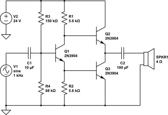

In an earlier question I asked about driving a speaker with a BJT transistor. @Jonk offered a push-pull amplifier design of his own, and @G36 noted its similarity to the JLH amplifier described in a paper from 1969.
In 1969 NPN power transistors were easier to come by than PNPs, so the JLH amplifier, and @Jonk's amplifier, use two NPN transistors instead of an NPN and a PNP. This is interesting to me because I'm trying to understand tube guitar amplifiers, and tubes are more or less NPNs. (I know they're more like FETs, but my point is, there are no PNP-like tubes.)
Using two NPNs requires a third NPN to act as a phase splitter. I've set this up, and it works fine:
The base of Q1 is biased to about 6.7V (give or take). The input swings +/-5V because it is the output of a previous voltage-amplifying stage. With no signal the emitter is at 6V and and the collector at 18V, giving plenty of room the voltage swings.
The problem is that when I attach the power NPNs, there is a zero-resistance path between the base of Q1 and ground, and all the current drains out. :-(
simulate this circuit
How can this be made to work? All the examples I've seen have the emitter of the "bottom" NPN (Q3 in this case) connected to ground. But that means its base will be at about 0.7V, and the base of Q1 will be 1.4V, and they will not be able to swing +/-5V, or at all.
In the JLH and @Jonk amplifiers, there is a PNP upstream of the phase-splitter transistor that I suspect has something to do with the solution, but just can't figure out how it works.
UPDATED: Added a decoupling capacitor in front of the speaker.

    Thanks for the detailed explanation! I realize now that I had everything completely backward. I did think it might be okay that the base of Q3 is restricted to about 1.4V, because it's the current that matters, not the voltage. But then I couldn't figure out where the voltage amplification came from. Now I understand, it comes from Q1 and Q2. In my initial attempt, the output stage was an emitter follower, and I was still thinking of it as a current amplifier, but here the output stage isn't an emitter follower. – Willis Blackburn May 14 '18 at 12:05

Your forgetting about the base-emitter diode junction all bjt's have. Your Q3 be junction is clamping the emitter of Q1 to about 0.65 volts.
It is because you have a totem pole design, which is good at getting the output close to the Vee or ground rail, but you need a base resistor for Q3 of 2.2 K or so. You can bypass it with a capacitor equal to 1/2 the be capacitance of Q3, or about 22 pF to 47 pF.
A push-pull output would not have this problem, but Q1 would not be able to drive it.
An alternative used in some op-amps is to add a PNP (2N3906) to drive Q3 with its emitter. To bias the emitter of the PNP use a 10 K to the power rail. Its collector would go to ground. A 100 ohm resistor off the emitter of Q1 would still prevent shoot-through currents. This add-on does not invert the signal, but shifts the drive to Q3 so its base has a pull-up resistor.
Try the 2.2 K resistor first, the extra PNP second.
  • Thanks. It did occur to me to add a resistor in front of Q3 since that's how you prevent a similar situation when using an NPN as a low-side switch. But the lack of such a resistor in the JLH and @Jonk amplifiers gave me pause. – Willis Blackburn May 14 '18 at 04:05
  • I did account for the BE voltage--I noted that the Q3 base is 0.7V and the Q1 base is 1.4V. – Willis Blackburn May 14 '18 at 04:06
  • Well, Q1 and Q3 *should* act as a simple Darlington and work just fine. I would question if Q3 is good or shorted at the be junction. The only shoot-through you have is Q2 to Q1 then Q3. Not likely with transistors rated for 40 volts. –  May 14 '18 at 05:20
