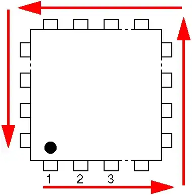

There are a number of ways of denoting which pin on an integrated circuit is pin 1. The most common is probably a small dot, either in the plastic molding or printed on it, but you also frequently see ICs with a notch cut out of one end.
Here are a few demonstrations: On a DIP, SOIC, SSOP, or similar package, you usually see either the notch or the dot:
or even both:
On a QFP, it's usually the dot:
or the dot plus notched corner:
and on a large BGA or PGA, and maybe also LGA (though I'm not too familiar with LGA) you might see a notch cut out of one corner:
SIP, TO-220, TO-92, DDPAK, and other packages just have their pins numbered from left to right as seen with the part number facing you. These sometimes have a dot as well:
In general, if you aren't sure, check the datasheet. Any nonstandard pin numbering will be explained in it. (and note that some pin numberings will skip numbers! This is especially true for DIP modules that have 'missing' pins.)
