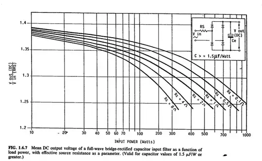

Update 1 THanks for photo of schematic. If you don't mind <20% efficiency, it might be ok. Transformer is 18Vac 4A = 72Watt max.
This full wave bridge in theory (with the right parts) can deliver 25.2(41% over AC) with no load but the 100Ω series gives low ripple but also huge loss.. eg 10V drop at 0.1A, so if you want 1V drop, consider what load you need.
for 72W @ 24V @3Adc 24dc/18Vac=1.33 using my chart 1.33 @ 72W >> equals 6Ω (not 100) Using Steven's photo you want the capacitor to hold up the voltage between pulses say 5~10% so if using 50Hz the pulses are 100Hz and instead of a time constant of 100mS, which would give you ~60% ripple you choose say 600ms so the load cap from T=RC, C=0.6sec/6Ω = 0.01Farad or 10,000 uF @30V or higher.

Here are some additional detail on items 7 not given in the other answers.
Courtesy of Dr Keith Billings "Switched Mode Power Supply Handbook" excellent book. enter image description here There are more curves for Ripple vs Cap value and R value.
There is a different curve for a half bridge if you choose that. Can you confirm output rating in Vac @Iac of transformer? It is not the same as DC. What accuracy do you need for Vdc output Ripple Vp-p? i.e. regulated or not?
