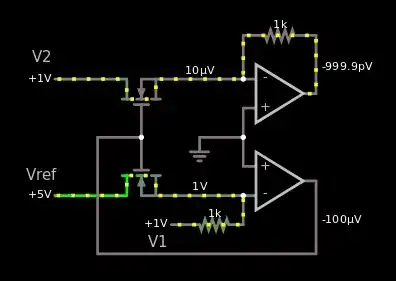

  • I have tried the MOS based multiplier in the link literally an inch above this word, but I don't know if I'm dumb. I can't get it to work in the simulator. See gif below for failure of MOS implementation. Or click this link for the simulation.

Here's the gif that shows my failure trying to make the MOS based one:
Figure 5, I copied the schematic from the wiki link above, yet it doesn't work in the simulator.
If it would have worked, then I should have seen the value 1 V somewhere as I changed the voltage of the reference from 5 V to -5 V.

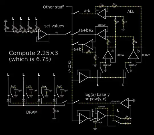

I am just putting this out here as a viable answer for future readers.
After reading Joren's answer I realized that many analog multipliers rely on matching components. So I thought to myself, why not just reuse components so the same component is used everywhere? That way I will automatically match everything.
So I looked up the typical diode based multiplier and saw that the anodes of all the diodes are always connected to the (-) input of the op-amp. Same goes for one pin of the 1 kΩ resistor.
Link to simulation.
In the image above, the multiplication 2.25 × 3 is calculated which results in 6.75. The very same multiplication is made in the... monstrosity below.
The "Value for one" is the voltage reference for one. So if it is 0.1 V and V1 = V2 = 1 volt. Then the answer will be 10 V which translates to the number 100 if 0.1 V is 1.
So I decided to mux the cathode and the other pin of the 1 kΩ resistor and voilà, there's a nice logarithm and exponential function that is matched. You can see in the gif below.
Link to simulation.
The gif is a little bit grainy, that is on purpose to scale down 8 MB down to 2 MB. Also the gif is sped up 2x, 28 seconds instead of 55.
I know it says "log(x) in base y" and "pow(y,x)"which is not true. I confused myself with the voltage reference. It's just log and pow with some random base. The clever mathematicians will know that it doesn't matter what the base is, you can convert any log to any other log.
The number 6.7 is shown at the end at the output of the bottom right op-amp. CircuitJS truncates 6.75 to 6.7 when presenting the numbers without any mouse hovering. Placing the mouse above showed 6.69 V, so 60 mV error which is less than 250 mV and therefor acceptable. According to.. not the best simulator.

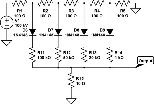

I recently came across the "Parabolic Multiplier" circuit in a 1968 analog computer. To multiply A and B, you start with two op amps to compute A+B and A-B. Next, you need a function generator that produces X^2 (i.e. a parabola). With two function generators, you compute (A+B)^2 and (A-B)^2. You subtract the two results with an op amp, resulting in 4×A×B, which after scaling gives you A×B as desired.
How do you get the X^2 function? An arbitrary convex function (such as X^2) can be approximated with a resistor-diode network. The idea is that each diode will turn on at a particular input voltage (controlled by the upper resistors), and provide a current (controlled by the lower resistors) to the output. The result is a piecewise linear function. (The component values below are arbitrary; I didn't work out the values for X^2.) A real function generator might have a dozen diodes for more accuracy. A function generator could be hardwired, or could have potentiometers so the user could set it to any desired function.
