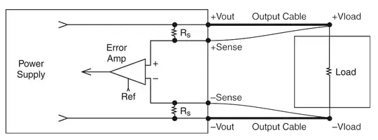

I think the question was not clear. There are no feedback resistors involved here. These are the resistors I am talking about: Rs and Rs shown below. They will burn up if they are low value and the output cable is disconnected (they are usually 100 ohm 0.5 watt; sometimes even 5 ohm or 10 ohm). But they will not burn up if they are 1K 0.25W. Image from here and here.

    Given the schematic you show, how much current is likely to be passing through the resistors? – Ignacio Vazquez-Abrams May 09 '18 at 09:39
  • In normal use, probably in nano amperes. But if the output cable is accidentally disconnected, then for a 30V supply, with a 100 ohm resistor, it may be up to 0.3A, or 9W. Clearly too much for a 0.5W resistor. and this is a well known problem. With a 1K resistor this becomes 30mA and 0.9W, easily solved. Increasing the resistor value does not change the sensing ability, as input is into high impedance op amp. So why is the resistor value limited to 5 or 10 or 100 ohms? – Indraneel May 09 '18 at 09:58
    Then you haven't looked closely enough. There is an error amp in between the resistors. – Ignacio Vazquez-Abrams May 09 '18 at 11:23
  • I agree, high value unbalanced resistors here would change the gain from unity to something else (and add noise) for a differential amplifier. But not so if it is an instrumentation amplifier perhaps? I don't have a differential amplifier there, due to only one sense wire. – Indraneel May 09 '18 at 13:06
Well, like you said, these resistors are clearly there for the sense lines to follow the output voltage. The only reason I can think of that they are low value is because with low value the sense line „react“ faster. Think of some small capacitance between the sense lines. If the output changes, then this capacitance is charged faster with low Rs.

The error amp generally has an input impedance in the few k region, as it is often really an opamp with feedback, so you want the sense resistors to be small (But large enough to be swamped by the cable conductance) to minimise error.
Secondly, an unconnected set of sense leads look like a capacitor, so you want the sense resistors small so that the resulting pole is way above the loop frequency to avoid impacting the loop stability.
Thirdly resistors add voltage noise, more for higher values, it's a physics thing.
One canny approach is to parallel the resistors with a pair of back to back diodes of sufficient robustness to handle the output current, means that you get at most a 1.4V error.
