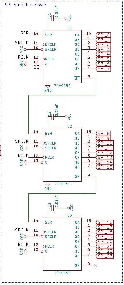

I want a RPi to act as a SPI master and be able to communicate with 24 SPI slaves. The SPI connection is full-duplex. The SPI slaves are about 50 cm away from the master (SPI runs on wires to an other PCB board not considered here). The 24 slaves will be Blue Pill STM32 boards, I have to use DMA on the SPI slave (CPU is very busy).
I have successfully communicated using SPI with 50 cm unshielded cables with a reasonable enough baud-rate for my application (9 MHz).
I'm pretty sure (though I have not tested) I will run into problems because of the multiple SPI slaves and long wires so I designed a schematic and I would like you to tell me what may work and what may not. There is also probably room for simplifications.
Design
  • I plan to use 3 daisy-chained 74HC595 shift registers to generate 24 outputs that will determine to which SPI slave the RPi will be connected to.
  • I plan to use CD54HC125 quad tri-state buffers to isolate the other SPI slaves when connected to one, these would be driven by the shift registers outputs.
Raspberry Pi
Raspberry Pi
  • SER, SRCLK and RCLK drive the shift registers
  • SPI_CS, SPI_MISO, SPI_MOSI and SPI_SCLK drive the SPI communication (RPi is the master)
Shift registers
Shift registers
  • SER, SRCLK and RCLK driven by the RPi
  • Daisy chained
  • Each SPI_x output will drive a tri-state buffer
Tri-state SPI buffers
  • There are 24 similar blocks like this, only the SPI_x changes
  • Each 01x04 male connector leads to one SPI slave
  • Output enable is driven by one of the shift register output (here SPI_0)
  • SPI_MISO is inverted because it is an output pin of the slave
This is my first KiCAD design, review and comments would be much appreciated before I buy components and try to test on a breadboard! After that I plan to layout the PCB and get it manufactured.

  • Those buffers are inefficient. You just need one. – Long Pham May 06 '18 at 17:25
    Are the slaves working on different voltages ? They can be daisy-chained, if you don't mind losing the speed. – Long Pham May 06 '18 at 17:34
    Why do think it's necessary for you to be isolating & buffering MISO/MOSI/SCK individually for each slave? Why don't you just use your x595's to drive individual CS to each slave and wire all of the other SPI signals together? A properly implemented SPI slave should be completely passive on the bus if its CS is inactive. – brhans May 06 '18 at 17:39
  • I didn't know that the hardware managing the SPI would switch the pins (all except CS?) to high impedance when not asserted through CS! I'll check it is the case with the STM32F1 – Victor Lamoine May 06 '18 at 18:57
Why would you "isolate the other SPI slaves when connected to one"? The whole point of using SPI is that CS line activates only one slave at a time.
Is it to deal with fan-out load on SCK and MOSI lines? A simple buffer driving signal "bus" would be sufficient for this.
Or is it to multiplex SCK signal as well? I don't think you need to do this. Instead of using shift registers to multiplex signals, you can use them to directly drive CS pins of the slaves. If your software does not output clock signal until correct slave selected there is absolutely no harm in "activating" them one by one without actual transmission.
I think the limiting factor in your design is line capacitance, which will grow regardless of what you connect to RPi outputs, buffers or slaves.
So, use shift registers to activate CS pins on slaves and use simple line buffers on SCK and MOSI.
UPDATE:
I was digging around for other stuff and found this chip that I think fits perfectly into your application. ADG731 is 32 channel SPI controlled multiplexer/demultiplexer. So, you can put it on the same SPI channel as your slaves to switch CS line between them (the mux CS will be separate, of course).
This would work even better than switching CS with shift registers as I suggested above, since
a) you would not be activating slaves right away while switching,
b) you can target any slave in any order, and
c) you will free 2 of the I/O lines used to control shift registers
Add tiny dual buffer for SCK and MOSI and you have faster directly-addressable 2-chip solution instead of 27 chips with address shifting.

  • My understanding is that with CMOS logic the fan-out is easily very high (> 1000) so not relevant in my case. I'm not sure what a "simple line buffer" is, an example would be appreciated – Victor Lamoine May 06 '18 at 18:59
  • I did not mean anything fancy, only that you don't need chip with 4 independent 3-state buffers. Something like [this](http://www.onsemi.com/pub/Collateral/NL27WZ16-D.PDF) or high speed [this](https://www.fairchildsemi.com/datasheets/NC/NC7WZ16.pdf) would be sufficient for your application. Of course if you already have HC125 or VHC125 buffers they should work just fine. – Maple May 06 '18 at 21:19
  • "The ADG731 switches one of 32 inputs (S1–S32) to a common output"... don't you need the opposite to drive 32 CS/ lines instead? – Eric Feb 12 '19 at 23:41
  • @Eric just couple paragraphs down from that you can find "These parts can operate equally well as either multiplexers or demultiplexers" – Maple Feb 14 '19 at 02:38
  • Thanks @Maple I didn't see that. It's odd they don't write it at the top of the datasheet. It's a pretty important piece of information. – Eric Feb 15 '19 at 09:11
  • @Eric Not really important, since most _analog_ multiplexers work this way. You can think of them as simple mechanical switches. This is principal difference with _digital_ multiplexers, that require certain voltage levels on the inputs and often include additional logic, like I2C state machines in bus switches, for example. – Maple Feb 17 '19 at 12:42
