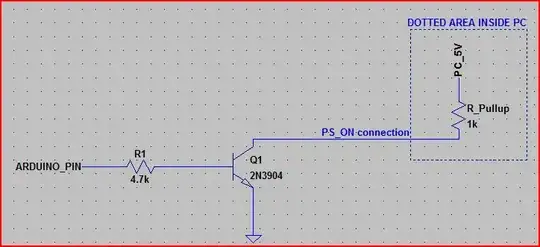

It seems this is to turn an ATX supply on by pulling the PC_ON (usually green) connection to ground. In this case the relay is a bit overkill, and a simple open collector NPN transistor circuit can be used:
PC On transistor circuit
The dotted area is inside the PC, so all you need is the NPN transistor (almost any general purpose will do) and the resistor (4.7kOhm is shown, but depending on the transistor gain, R1 can be between say, 50kOhm and 1kOhm - between 1kOhm and 10kOhm should work with just about anything though)
The R_pullup of 1kOhm is assuming about the worst case - it will probably be between 2kOhm and 10kOhm. The circuit as shown would work with a pullup down to around 100 ohms though if needed.

  • the thing im switching on is a atx computer PSU, to turn it on you just bridge a certain wire to a ground wire, a relay could do this yes? – Lewis Denny Aug 06 '12 at 13:45
  • Yes, a relay could do this. If you are referring to the green power on signal connection, since the current is very low you could do this with just the transistor itself (the Arduino would not be isolated from the ATX in this case, but that may not be an issue) – Oli Glaser Aug 06 '12 at 14:26
  • The [ATX 2.2 spec](http://www.formfactors.org/developer%5Cspecs%5Catx2_2.pdf) does not give a value for the pullup resistor, only that it is attached to +5V (see page 21). It's probably safish to assume it's not less than 1k, which would give 5V / 1kOhm = 5mA max. Since it's pulled up to +5V, at 5mA you could drive it from the Arduino pin, but I'd use the transistor (or relay if you want to have things isolated) anyway just in case. – Oli Glaser Aug 06 '12 at 14:39
  • So would a transistor be just as safe as a relay, it's not like there will be any power surges though the line or anything – Lewis Denny Aug 06 '12 at 21:25
    Yes the transistor will be perfectly safe to handle this, the only difference is the relay would provide isolation between the Arduino and the ATX, but if you don't need that then use the transistor. The ATX outputs are isolated (from the HV mains side by a transformer) anyway. In fact if you did need isolation, you would be better to use an [optocoupler](http://en.wikipedia.org/wiki/Opto-isolator) anyway for such a small load, the relay would be overkill. – Oli Glaser Aug 06 '12 at 21:35
  • @lewisdenny - added an example circuit for the transistor. – Oli Glaser Aug 06 '12 at 21:57
  • Ok excellent I'm going to go buy the components and test this out thank you, so the pin on the NPN that's facing down on the diagram is connecting to the ground of the pc? – Lewis Denny Aug 07 '12 at 06:19
  • @lewisdenny - yes, the Arduino ground and ATX ground connect together. – Oli Glaser Aug 07 '12 at 06:21
  • Ok awesome, and what wattage would you recommend for the resistors? – Lewis Denny Aug 07 '12 at 07:36
  • Remember that R_pullup is inside the PC, so you don't need to worry about that one. For R1, a standard 1/4W (or even 1/8W) will be fine, as the wattage it handles is only ~4mW. You can calculate by Vresistor * Iresistor. Vresistor = 5V - 0.6V = 4.4V (0.6V based emitter drop on transistor) Iresistor = 4.4V / 4.7kOhm = 0.93mA. 4.4V * 0.93mA = 4mW – Oli Glaser Aug 07 '12 at 09:58
