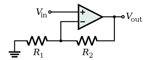

If you are happy with feeding a signal into a "block" and getting two signals out that are 90 degrees apart may I recommend this: -
Select R = R1 = R2 = \$\sqrt{\frac{L}{C}}\$. This ensures that OUT1 and OUT2 have a phase differential of 90 degrees across all frequencies. The phase relationship between OUT1 and OUT2 is always 90 degrees but amplitudes do change with frequency as with any high-pass or low-pass fliter.
  • This seems nice but I will need to check out how much the different signals might be attenuated for each path. I suppose it will depend on the loads which I am attaching ta OUT1 and OUT2. These will likely be 50 ohm loads. – Jagerber48 May 02 '18 at 17:02
  • @Jagerber48 You don't have to load this, directly, in fact, it's recommended that you buffer them, or even make them active. – a concerned citizen May 02 '18 at 17:05
    @aconcernedcitizen please don't pre-empt this. Of course the OP can load the outputs with 50 ohm. In fact the loads can replace the resistors providing that the correct ratio of L:C is used to make \$\sqrt{L/C}\$ = 50. – Andy aka May 02 '18 at 17:08
  • Yes with subsequent buffering and/or amplification I see that this could be a general solution. – Jagerber48 May 02 '18 at 17:18

  • *Any passive, or active filter will only add a 90 deg phase shift at a certain frequency.* that is a very feeble thing to imply. My answer's circuit will produce two outputs that are 90 degrees apart across the full spectrum. – Andy aka May 02 '18 at 16:58
  • @Andyaka Yes, but at what amplitude? Otherwise a simple differentiator will do the same thing. A Hilbert transformer solves that. At any rate, it's one variant of an answer. – a concerned citizen May 02 '18 at 17:00
  • See my comment and edit for clarification. I am not looking for a wideband phase shifter. Only a way to phase shift a narrowband signal which may fall in the indicated range. It is ok if I need a different tuning or different device for each frequency. – Jagerber48 May 02 '18 at 17:00
  • @Jagerber48 Then a HT will be too expensive schematic-wise. It would also induce a necessary delay (see the picture), which may get in the way. In this case, Andy's solution, seems simple enough to be able to tune it to a desired frequency by using a twin potentiometer and properly chosen L and C. – a concerned citizen May 02 '18 at 17:04
    @aconcernedcitizen there you go again - it doesn't need to be specifically tuned to a frequency. Once set (and loaded correctly) it will produce 90 degrees from DC to infinity. – Andy aka May 02 '18 at 17:11
  • @Andyaka Your circuit is nothing but a "matched" lowpass-highpass, and the matching is done at a specific frequency. Anything above (lowpass) or below (highpass), will be attenuated. My 1st comment started with "yes, but at what amplitude?". Yes, you don't have to tune it, but you will have amplitude differencies, thus a tuning would be welcome. Not lastly, what's with the aversion? – a concerned citizen May 02 '18 at 17:17
  • @aconcernedcitizen MY answer clearly states the amplitude limitations and YOU should either expose some extra crit of my answer or stick to your own answer. I am concerned at you trying to imply it needs tuning to obtain what the OP asked for. I stated the limitations in my answer and there is no need to try and micro-manage a conversation between myself and the OP. Back-off. – Andy aka May 02 '18 at 17:33
  • @Andyaka My cmment was related to OP's problem -- we're *all* trying to solve it, no? So if OP says he/she might need tuning or else (`Yes with subsequent buffering and/or amplification I see that this could be a general solution`), then that's what OP needs, and answer or comment, is help given. You wouldn't have snapped if, for ex., Marcus Muller would have made the comment, so if you need to take a break, do so, if you have problems of your own, solve them, but don't lay them on me. This is a public site, no implying, no micro-managing, anyone can make a comment, so please watch your tone. – a concerned citizen May 02 '18 at 17:47
  • YOUR comment was made 50 minutes ago - about 1 minute before the OP's so I think you are trying to cover your tracks here. Basically you steered the OP into thinking something was potentially problematic when it wasn't. Please be very careful about doing this in the future because I don't suffer fools gladly. – Andy aka May 02 '18 at 18:10
