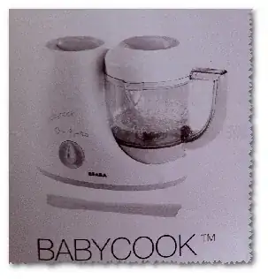

I bought for my baby this product from eBay:

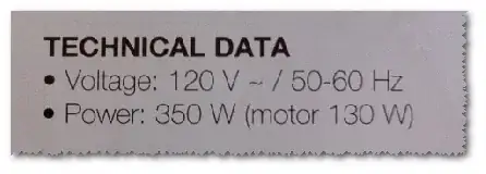

which has these technical data:

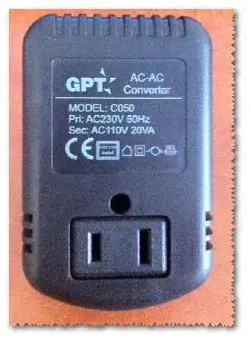

And so, I also bought (from Israel) this adapter:
the device has 2 functions:
  1. chop
  2. steam
When I plugged it to the wall , the chopper was working ( the motor was working). ( just tested it for 5 sec)
But when I try the steam ---- it stopped working , and also the chop stopped working.
Obviously, something is wrong.

Most likely the adapter. It's rated for 20 VA, which is about 20 W. The Babycook uses 350 W, that's 20 times as much. Pretty bad for the adapter. If it doesn't have any protection it's probably dead now. It may have overload protection, and then it would switch off soon after you switch the Babycook on. In any case it won't work, and I wouldn't try it either. You need a higher power adapter, or rather a 220V/110V transformer. 500 VA is not a luxe.
The adapter is, or was :-( a travel adapter for low-power devices like toothbrushes and shavers.

  • Thank you so very much... , please ... how do you convert VA to W ? ( formula) ....Again , Thank you. – Royi Namir Aug 04 '12 at 08:21
  • So most of the chances , is that the Babycook is still working but waiting for the right voltage/Watt ....right? – Royi Namir Aug 04 '12 at 08:22
  • @Royi - I added a link about the difference between watts and VA to my answer. I guess the Babycook will still be OK, indeed it just didn't get enough power. – stevenvh Aug 04 '12 at 08:25
