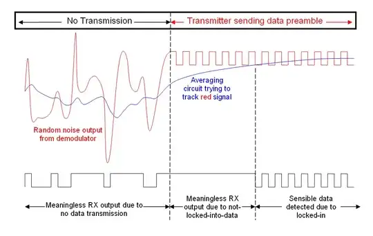

For the bigger "radio picture" you have to send a preamble to get things started i.e. you can't just hope to get lock straight away because there are many factors involved. Here's a picture I drew some time ago that explains how a preamble would work on a simple FM radio transmitter and receiver: -
And here is the previous answer that included that diagram. More useful information contained.

Radios don't generally do this, they more likely have a preamble which is has a warm up burst of 1/0's for the tx and rx to stabilise, and get bit sync, then a magic sync block, eg 32 bit unique pattern to initially sync blocks, then data blocks with error correction. Note that error corrected data blocks can be self syncing - they are only valid when sync is correct.
The codes are chosen to always have enough 1/0 transitions to keep in bit sync. ie. you can't get a run of 32 1s, there will always be a transition every N bits, worst case.
If you do use a UART over radio, the preamble should be chars that have a single 0/1 transition in them, so that the UART can get back in sync. As should be obvious, if you data was 1/0/1/0 then the uart would never know which edge was the start bit. As you can see from Andys diagram it wants to have roughly equal 1/0 balance. So 0xF0 is ideal, the sequence will be start=0 0000 1111 stop=1
