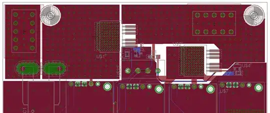

How closely do you pack your thermal vias?
The above I would consider borderline excessive. That is, if the pads with holes, were directly under the thermal pad.
  • Too many holes
  • Holes too close to each other (or too big)
  • Holes too far away
Holes should be 10 mil in diameter and spaced 25 mil apart. That leaves 15 mils of copper between vias . The diagonal holes have less copper than the diameter of the vias. It appears the vias may be too big.
The vias in contact with the thermal vias are the only really effective vias. Vias further than 3 mm from the thermal pad are ineffective. The copper not under the thermal pad is best used for convective and radiation heat transfer.
This is actually a horrible thermal design. The thermal vias should be on the thermal pad. The thermal area (the A in Fourier's Law) is the cross sectional area of the copper's thickness. PCB copper is too thin for sufficient conductive heat transfer. In this design, the heat transfer is first lateral then through the vias. The lateral heat transfer is unnecessary, inefficient, and ineffective.
