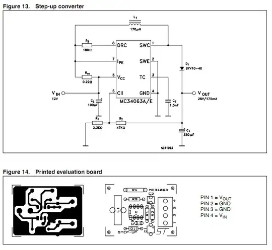

You will need to make some jumpers in the ground plane, but this won't cause any problems if you avoid making large cuts. I made a quick and terrible image in paint to illustrate:
ground plane large cuts vs jumpers illustration
As Neil mentioned, your ground return paths do matter, you shouldn't just consider them finished when they enter the ground plane.
