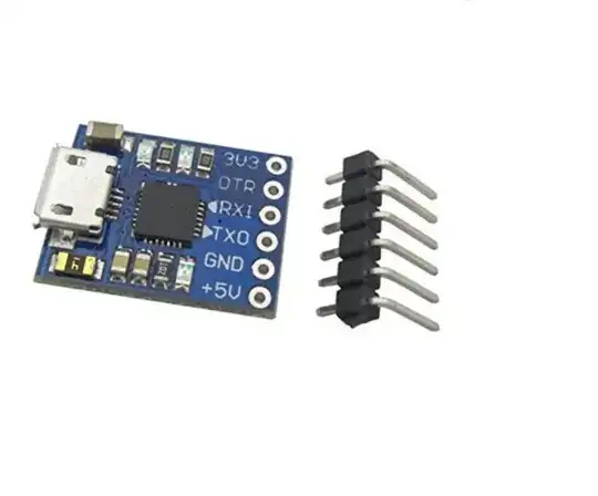

I have this TTL-to-USB-serial device (supposedly from WINGONEER, who doesn't seem to have any documentation on how to use it):
https://www.amazon.com/gp/product/B06XY18XLL
picture of board
I'm using it to hook up serial console on a system that has a 3.3V TTL serial debug connector with 4 pins: ground, tx rx, and a +3.3V supply. Since the USB adapter above produces 5V and 3.3V outputs on those pins, I left them unconnected. My expectation was that the adapter would only power up when the USB port is connected to a USB host, and that it would otherwise remain unpowered.
To my surprise, when I tried powering up the system it's connected to without the USB cable connected, the LEDs on the adapter lit and it seemed to be operational (power LED steady, activity LED flashing). Presumably it's drawing power over the RX line.
Is this potentially damaging?
I found the datasheet for the CP2102 chip and it indicates that the 3.3V can be configured as a supply or an output, but it seems to be configured as an output on this board. Would it be safe to hook it up?

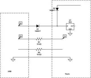

Well if you device is powered, the it will power this adaptor.
You must decide what is powering what.
The +5 is probably connected to USB +5. If you connect it to your (powered) device +5, then your device will try to power the PC through its usb port. Or maybe the other way around. It's confusing. It probably won't end well.
If your device is always powered, don't join 3,5V to your device.
If usb only is powering everything, then connect 5V
If you want either or both ends to be powered, you need to use a schottky diode to connect them (1n5817) so they don't fight

  • Put a resistor in series with the TX line going from your device to the adaptor RX pin e.g. 10k or 22k. What powers your device? – Henry Crun Apr 25 '18 at 01:48
  • The device is powered by its own power brick with 5V output. Adding a resistor sounds like it would make the issue go away but there's nowhere really good to put it except cutting out part of the wire and splicing it in the middle. – R.. GitHub STOP HELPING ICE Apr 25 '18 at 02:01
    and the problem with that is? The resistor is correct, as you have no control over voltages at each and, so current will flow one way or the other, trying to power one part up through its cmos protection diodes. In practice probably not going to blow anything up from 3V. – Henry Crun Apr 25 '18 at 02:06
