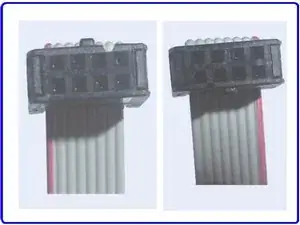

There are actually 6 SWD pins used for programming (if you program via SWD) which are V+, GND, RST, SWIO, SWCLK and SWO. If this board was programmed via SWD, there are lots of pre-made flat cables used for programming, such as this one:
And the programmer will have a pre-made pinout that the designer needs to follow. That is the likely explanation for the extra pins on the header. It usually depends on the programmer being used as to which header is used in the design.
