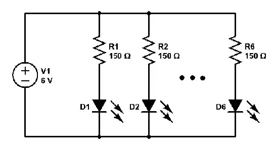

Your series resistor is the current controlling device, but you made a calculation error. The resistor value is not 6 V divided by the current, but the voltage across the resistor divided by the current, and that's only 2.7 V, being 6 V minus the 3.3 V of the LEDs.
If you would now take a 150 Ω resistor, for (6 V - 3.3 V)/ 150 Ω = 18 mA, that 18 mA will be the total for all LEDs. So each LED would get only 3 mA. But don't decrease the resistor. Instead use one 150 Ω resistor per LED. Paralleling LEDs is a Bad Practice™; if their voltage is not exactly the same one LED will draw much more current than the other. Giving each LED its own series resistor balances the currents.
This may not be a solution for the problem that they go out, but it's something you'll have to fix anyway. Then check if the behavior changes.

  • I changed the circuit per your suggestion. It works perfectly. Much brighter and more evenly distributed. However the reason of the problem is still unknown. I tried both circuits on my breadboard, and the problem was not reproduced. Could flux disturb the flow in the circuit? Because I didn't do a good job cleaning the soldered circuit. – rzetterberg Aug 02 '12 at 11:31
    @rzetterberg - Fine! No, I wouldn't know what caused the problem in the first place either. Flux seems unlikely because I would expect that it was off all the time, certainly not switching. Anyway, I always try to exclude all possible uncertainties before starting troubleshooting. In general you'll find the solution faster if there's just one problem than when there's different ones which may affect each other. – stevenvh Aug 02 '12 at 11:43
