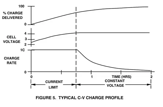

See this document from TI: Battery Charging (application note - TI literature number: SNVA557).
Excerpt:
Although the text reports the charging method in the initial phase as "Current-limited CV", from an electrical POV it is just a CC charging phase.

Li-ion battery charging follows a profile designed to ensure safety and long life without compromising performance (Figure 2). If a Li-ion battery is deeply discharged (for example, to below 3 V) a small “pre-conditioning” charge of around 10% of the full-charge current is applied. This prevents the cell from overheating until such a time that it is able to accept the full current of the constant-current phase. In reality, this phase is rarely needed because most modern mobile devices are designed to shut down while there’s still some charge left because deep discharge, like overcharging, can damage the cell.
In all this, see the focus of not overcharging the cells. Without a current limiter a CV supply cannot guarantee that the maximum current won't be exceeded, since the charging current depends on the actual voltage applied to the cell and the internal state of charge. Even applying a voltage well below the nominal cell voltage (3.7V), say 3V, to a deeply discharged cell (say, 2V open-circuit voltage) could cause too much current to flow.
