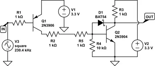

For the line which is driven by slaves, I would suggest that if capacitive loading wouldn't be a problem, you have connect each slave's TX line to the bus through a series resistor, and then set each state's TX pin to float when idle. Make the resistance as low as it can be without allowing an unacceptable or damaging level of current to flow in case of bus conflict.
If the required series resistance to prevent damage, combined with the parasitic capacitance, would limit speeds to be unacceptably slow, then I would suggest using a current-based approach where the slaves source current if they want to transmit. Something like:
The left half is the transmitter, and the right half is the receiver. Note that if the Schottky diode is omitted (or if a non-Schottky diode is substituted) the receiver circuit will not operate nearly as well, since Q2 will be driven into saturation and will take awhile to come out of it. Adding the Schottky diode will prevent Q2 from turning on fully, thus allowing it to turn off faster.
