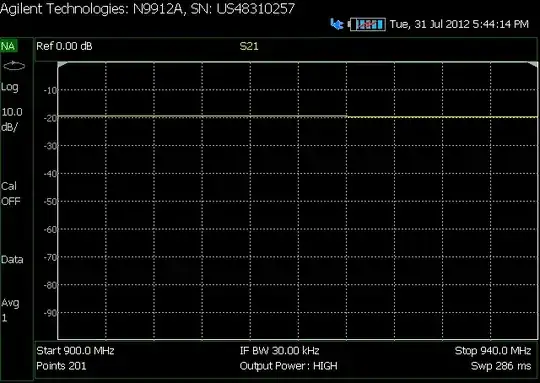

I have prototyped one using just off the shelf resistors in a T-pad configuration that gives me a decent level of attenuation (pretty flat 19dB) when I perform an S21 measurement using my network analyzer.
However, the smith chart is all over the place when I measure S11.

Here are the log plots of attenuation over the frequency range I am interested in: First no attenuator:enter image description here
Second with attenuator:enter image description here

  • @JGord your picture "with" attenuation is S21, we need S11, although S21 shows it is not only working well as a 20dB attenuation and seems to be very frequency resilient, but not how much power is reflected. – Kortuk Aug 01 '12 at 20:49

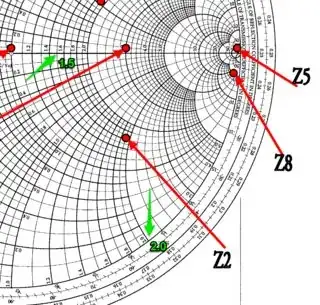

Example (again borrowed from the article)
Find the complex impedance of the point Z2 on the Smith Chart below
URL to the larger resolution image
Solution:
Find the corresponding circles for r and x. Corresponding values are located at the horizontal axis (r) and at the big circle around the Smith Cart (x)(marked with green arrows): r=1.5, x=-2 (we added the minus sign because the point is located in the bottom half plane).
Remember to multiply by Z0.
$$Z2 \equiv {Z_L} = {Z_0} \cdot z = {Z_0} \cdot (r + j \cdot x) = {Z_0} \cdot r + j \cdot {Z_0} \cdot x = 50 \cdot 1.5 + 50 \cdot j \cdot ( - 2)\,\Omega = 75 - j \cdot 100\,\Omega$$
