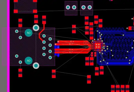

FIRST PROPOSED INCOMPLETE LAYOUT:
layout
FIRST CALCULATIONS:
differential impedance microstrip calculator
MY QUESTIONS: Should I care about matching the 100 Ohms differential impedance between the transmission lines connecting the PHY with the RJ45 jack and magnetics given the length of this traces? Would it be better to cross the traces maintaining the 0.956 mm width or to reduce traces width first and do the crossing afterwards? What would the optimal clearance in between the two pairs be? Would you suggest any other extra layout considerations? (apart from a 4-layer stackup).

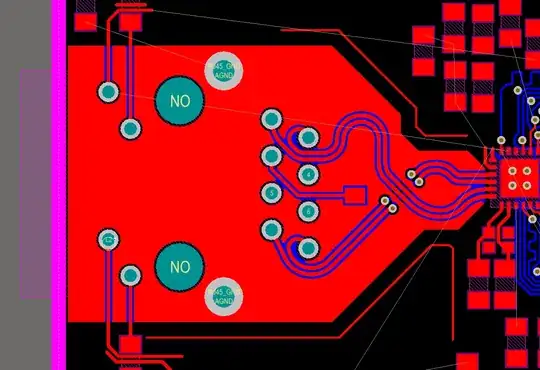

EDIT 4:
SECOND PROPOSED INCOMPLETE LAYOUT:
TOP LAYER SECOND ATTEMPT
BOTTOM LAYER SECOND ATTEMPT
Signal traces are 0.29 mm wide and 23 mm +/- 0.5mm long. ZDiff seems to be 100 Ohms. Does this design look like 100 Mbps capable? Would you suggest any modifications?

  • This cross you've made is no good. The short segment on the bottom layers has split the return path for the top pair. You should avoid that. Can you move the connector to the other side of the board? – Mike Apr 21 '18 at 07:13
  • @Mike I was trying not to, but could. It seems the Ethernet PHY was designed to lay on the opposite side of the board because both RMII and ETH lines get crossed a lot. I guess I'll have to figure how to reflow solder the board in order to keep the PHY on the other side and post back ! – Juan Manuel López Manzano Apr 21 '18 at 15:55
Your signal tracks for the 10/100 PHY with 3ns rise time are overly fat compared to the data signals which you have carefully matched the lengths yet ignored the crosstalk effects. This shows you do not understand what rules to follow in your layout.
Although your layout may work, it is always best to follow the supplier's recommendations for layout, Vdd decoupling, cross-talk track separation, ground planes (do's and don'ts) , supply plane decoupling , ethernet AC coupling the terminations to AC gnd and trace bevels on corners to reduce E-field gradient emissions.
A thinner board dielectric makes it easier to achieve lower impedances so that you do not need such a narrow gap.
Also since the min. rise time of your chip is 3ns for the ethernet port, or just over 100MHz BW transmission line impedances are not that critical since it 100MHz has a wavelngth of 1500 mm on FR4 and mismatched impedances for 1% of the wavelength will not degrade the signal integrity , however other factors above may add to noise if not followed.
Since I had to guess which IC you were using and none of the other details > which I commented on were mentioned, consider this bonus info.
If my assumptions were wrong, just let us know with more details in question.
BTW, Earth ground via the caps on either side of the magnetics serve to shunt the common mode noise with centre tap to Vdd with proper decoupling. If you have no Earth ground and just a chassis and STP shield gnd, then use that, which may work depending on proximity of noisy SMPS etc.
  • Thank you very much for the layout recommendations you posted, they seem much more comprehensive than my PHY datasheet ! The data signals on the right are in a CPW with ground configuration discussed [here](https://electronics.stackexchange.com/questions/360139/ethernet-rmii-on-two-layer-pcb) that I hope ends out working, I didn't know this same configuration existed for diff pairs too and I'm about to implement this configuration. I also added a schematic showing the way I decoupled and filtered AVDD, VDD and connected the AGND plane that hasn't been poured yet. – Juan Manuel López Manzano Apr 19 '18 at 14:52
  • I think All RMII nets were length matched to 29.9mm +/- 0.1mm. is excessive spagetti and wasted space, when you could have made it 8 mm +/-5mm or +/- 30 picoseconds – Tony Stewart EE75 Apr 19 '18 at 15:08
  • Stewart EE since 1975 Thanks for the suggestion ! If no overprice would be paid for a 100 mm x 100 mm one spin board and space wasn't an issue, would matching the impedances and length tightly be better than keeping traces as short as possible? Or shall I move the PHY as close to the microcontroler as possible even if a lot of spare PCB space was available? – Juan Manuel López Manzano Apr 19 '18 at 19:33
  • It depends how hard to want to try to get 100M working. This is already marginal with rise time and adding more pF with longer traces doesn't help. Its not huge 0.6~0.9pF/cm depending – Tony Stewart EE75 Apr 19 '18 at 20:20
