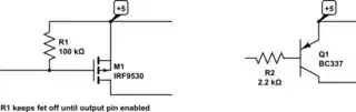

This arrangement of 2 fets is only needed because 12V is higher than 5V, and Q1 is needed to level shift.
You only need a PFet connected directly to your micro, when they run from the same (5V) supply.
You could also use a pnp transistor (BC337). There is no issue with VGS, but there is base current used when turned on. That is what I would use for switching the LCD backlight led, for example.
