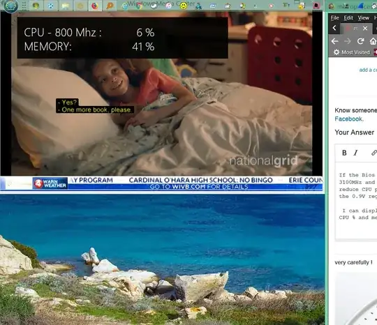

My i7 (8cpu) goes from 3101 MHz to 800 MHz and instantly steps 1100, 1300,1500... etc
If the Bios chooses x31 as in my case, then the CPU runs at 100MHz x 3100MHz and with a binary counter in the CPU choose from x8 to x15 to reduce CPU power at the same time as it regulates the CPU chip voltage in the 0.9V region all to conserve power.
I can display with my cursor in upper right corner on Win8.1 along with CPU % and memory %
