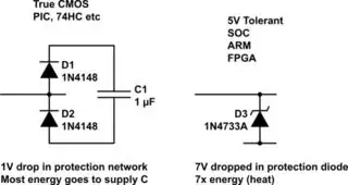

Is you compare a small PIC/74HC vs the SOC in a raspberry pi or
PIC or other small 5V micro or 74HC logic: - small number of pins - plenty of room for wide metal tracks - high current pins 50mA capable = large fet area - true CMOS protection circuit - offloads static to the power supply with only diode drop - big pads+big transistors = big protection diodes = big fail current - basic cmos process used will be 3.3 or 5V
SOC / super-micro/fpga - Bazillion pins zigzagged bond pads, fine metalisation to thread between them - small fets, low current capability. Must be like this as it has so many pins - ?V tolerant input - protected by a zener arrangement: static is dissipated in the protection diode itself, not offloaded to supply rails - tiny bond pads and fets = tiny protection structure = tiny fail energy. - low voltage basic process 1.5V -2.5V
So in summary:
Hi-tech parts: 7x dissipation in 1/10th the pad/transistor/metalisation area, in a cmos process 2x more voltage sensitve = 140x less robust. [flame war begins in carpark when bar closes]
Yes there is a big difference in the need for protection. But there are big differences in robustness, and they should be deliberate choices.
