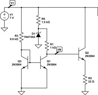

FYI, here is a constant power, constant current circuit. This also meets your objective using very cheap components, and without requiring a very specific thermistor.
The constant current emitter follower Q2, has its reference voltage subtracted by the current mirror Q1Q3 in proportion to the supply voltage. The result is a linear dropping current i.e. constant power when the slopes are balanced. R3 is the primary slope adjuster.
We can simplify this using Q4 to replace the zener (Q3 cancels Q2 VBE, so Q4 provides the constant reference voltage). This gives an NTC, but this is what we want. 2 dual-npn and 3 resistors is about as cheap as you can get.

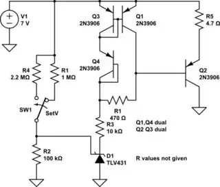

Flipping the circuit around we can gate it with a TL431 to control stop voltage, and give near zero off current
