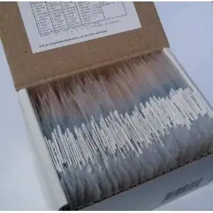

Like I suggested above, check out this resistor kit:
860 resistors (10 of 86 values), metal film, 1/4 W for $17.99. Note that they are 5-band resistors - a little harder to read, but not much.
Here is the product link.
