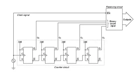

I know, for example, if we set an up counter with 3 FFs, CBA. Followings are the block and the waveform diagram:
After the count 001, it will appear 000 (the 2nd CLK period), which makes the operation false. In fact, this situation is inevitable in real life because propagation delay is inherent for all flip flops.
As a result, I wonder how can we implement asynchronous counters?

  • The problem with asynchronous counter is the "ripple". Say take an example of 4-bit asynchronous counter counting up. The transition from 0111 --> 1000 goes through or ripple through 3 intermediate states because of accumulaton of propogation delays of each preciding Flip-Flop. These are glitches in the asynchronous counters.
If you plug-in some LEDs at the 4-bit outputs of the counter, you wont notice this glitch at all as these ripples are fast enough and you see that its counting correctly. But if you are feeding this count to some other digital logic for sampling, these glitches may cause unwanted errors.
  • A solution to the above problem is strobing. It is basically like latching the count output.
The idea is to sample the count, only after it is settled to a stable value. In the above circuit, the count transition is happening at positive edge of clock. What we do is, we sample the count only when clock is low. The clock is like 'enable' signal of the strobing circuit. The one condition here is that, by the time clock transits from high to low, all ripples should have been passed by. i.e, the accumulated propagation delay should be less than clock's "high time". It make sure that correct count is sampled every time.
  • The problem with asynchronous counter is the limitation of clock frequency/limted speed, due to accumulated delays of each Flip-Flop. The counter should satisfy: $$\Sigma d_i < T_{clk}$$
    Due to these design complexities, we prefer synchronous counters, where timing is predictable.
