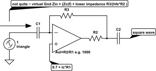

This is just off the cuff.. you can work it out.
The assumption is R3 >> R2 >> R1 , if Vin has Rs then AC gain is R3/Rs after HPF breakpoint
