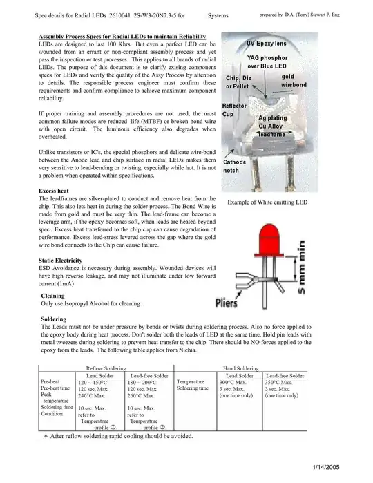

When reverse biased the current is rated usually 1 µA for RY and 10 µA for BGW colors.
Imagine that reverse biasing is extreme micropower and measure it and if there is no ESD clamp that something of the order of 100 µW has more power per square micrometer than forward biased current 100 mW per square mm because the path is MUCH DIFFERENT.
It's not like a Zener diode limited by power in either direction. The band gaps can abruptly fail or softly.
So the stress is invisible and wounds the junctions differently. The result can be seen with a higher junction capacitance or an off-colour or a lower intensity or a wounded to reduce MTBF significantly.
Whether it can withstand it briefly or for a while or not is irrelevant. Experts understand the stress level reduces reliability, or performance.
If you don't understand why absolute maximum ratings exists, don't ignore it or doubt it or when you least expect it... hmm, it's not working.
An Engineering guide I made to client in 2005 before I went on site visit to resolve ESD and solder problems causing 1% field failures fixed later by my process improvement recommendations. enter image description here enter image description here
