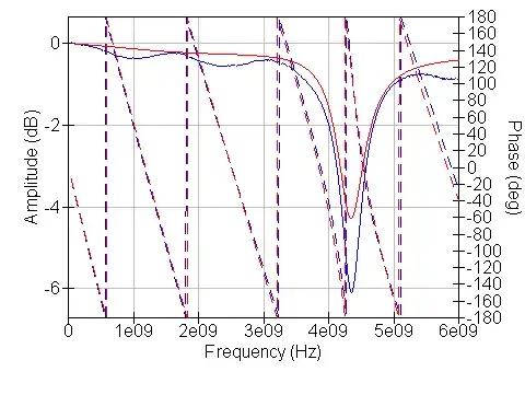

Here's where I'm running into a bit of trouble. I have been unable to find optimized values (for board properties and parasitic elements) which match the measured S11 perfectly. In particular, each set of component values shows a resonant peak at some frequency, but in my model the peak typically falls at a slightly different frequency. For example, here is a plot comparing one measurement with its associated model:
Comparison of model and measurement - poor match
Here, the measured value is shown in blue and the model in red. Solid lines show amplitude of S11 and dashed lines show phase. For this measurement, L15 = L5 = 2.2 nH and C16 = C13 = 1.0 pF.

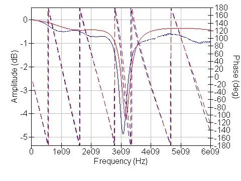

Some component values match better than others, so the problem does not seem to be a fixed parasitic inductance/capacitance on the board. Here is an example (using the same optimized board properties and parasitics as above) where the model matches quite well:
Comparison of model and measurement - good match
In this case, L15 = L5 = 1.0 nH and C16 = C13 = 1.0 pF.

  • I suspect the error is in a reduced effective er and worse loss tangent . What material grade is it? datasheet? polyamide Getek? – Tony Stewart EE75 Apr 01 '18 at 21:07
  • I suspect that you might be using the wrong transmission line model. Does the qucs model include the reference GND on the 2nd layer? (ie - did you use a Coplannar Waveguide or Grounded Coplannar Waveguide ? ) – Mike Apr 01 '18 at 21:16
  • You can also model it here and change length and impedance of the wrong 75 Ohm impedance here https://goo.gl/1rXG6Z and add delay paths per your design. – Tony Stewart EE75 Apr 01 '18 at 21:29
  • Is that really only -4dB of s11? – Tony Stewart EE75 Apr 01 '18 at 21:33
  • @TonyStewart.EEsince'75 I believe this is the datasheet for the FR4: https://us.beta-layout.com/download/spezifikation/Datenblatt/deu_datenblatt_basismaterial_sn_fr4-1.pdf The PCB was manufactured by PCB-POOL and follows their 4-layer specs: https://us.beta-layout.com/pcb/technology/specifications/ – Michael Cooper Apr 02 '18 at 02:19
  • @Mike The Qucs model is for a "Coplanar Line". In the options for the model, it includes a "Backside" property which can be set either to "Air" or "Metal". For my transmission lines, I've set it to Metal, so I believe it should be modeling a GCPW. – Michael Cooper Apr 02 '18 at 02:21
  • @TonyStewart.EEsince'75 Can you elaborate on your surprise with the S11 measurement? The blue lines above are based on measurements VNA measurements. Are you expecting more or less attenuation? – Michael Cooper Apr 02 '18 at 02:26
  • Don't you want a return loss more than 15 dB in pass band? – Tony Stewart EE75 Apr 02 '18 at 02:42
    @TonyStewart.EEsince'75 I think you may be misunderstanding the experimental setup. As indicated above the photo, the antenna was not installed for these tests. What I'm looking at is simply a reflection off the end of the feed line. The resonant peak is caused not by a radiating element, but just by the L-C pairs in the "matching" circuit. What I'm trying to do in this experiment is not to measure the effectiveness of the antenna, but only to develop a model for the circuit board so that I can later optimize the matching circuit. – Michael Cooper Apr 02 '18 at 02:56
  • @TonyStewart.EEsince'75 I have removed the antenna from the photo in the original post, to eliminate any source of confusion. The photo now shows the actual experimental setup. – Michael Cooper Apr 02 '18 at 03:45
  • I would also recommend using Getek408 or one of the high speed dielectrics and use 2:1 width to height or verify using Saturn PCB Design tool V7.04 and checkout how Er effective tab reduces Er at any f like 2.5GHz to 5GHz something QUCs may not support. – Tony Stewart EE75 Apr 02 '18 at 04:33
  • (typo. corrected) I was not confused rather assumed differently on your approach. I expect you should terminate the antenna port with ideal correct impedance and expect >15dB Return loss. I see now it was unterminated. Then you would validate your antenna impedance then change your impedance conjugate match – Tony Stewart EE75 Apr 02 '18 at 04:39
  • @TonyStewart.EEsince'75 It looks like I was wrong about the substrate. The manufacturer has informed me that they use Isola DE104, which at least provides typical values up to 5 GHz: http://www.isola-group.com/products/all-printed-circuit-materials/de104/ – Michael Cooper Apr 02 '18 at 17:04
  • What is you W/h ratio for 50 Ohms? rememember I said 2:1 see my update – Tony Stewart EE75 Apr 02 '18 at 17:47
  • My transmission line has width 0.45 mm, gap 0.15 mm, substrate thickness 0.38 mm and conductor thickness 0.035 mm. AppCAD gives a 50.3 ohm impedance for this configuration with a ground plane. – Michael Cooper Apr 02 '18 at 22:37
