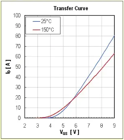

Admittedly, this is an issue with any type of MOSFET, old and new, but the older processes were a bit more forgiving. This is the graph that has most of the relevant information:
MOSFET Transfer Curce Vgs vs Id Source: APEC, IRF
For a high gate-to-source voltage, an increase in temperature will lead to an increase in on-resistance, and a decrease in drain current. For switching applications, this is just perfect: MOSFETs are driven into good saturation with a high VGS. Think about paralleled MOSFETs, and keep in mind that a single MOSFET has many tiny, paralleled MOSFETs on its chip. When one of these MOSFETs gets hot, it will have an increased resistance, and more current will be "taken" by its neighbors, leading to a good overall distribution with no hotspots. Awesome.
For a VGS lower than the value where the two lines cross, called the zero temperature crossover (cf. IRF's App'note 1155), however, an increased temperature will lead to a decreased RDS,on, and in increased drain current. This is where thermal runaway will knock on your door, contrary to the popular belief that this is a BJT-only phenomenon. Hot spots will occur, and your MOSFET may self-destruct in a spectacular way, taking with it some of the beautiful circuitry in its neighborhood.
Rumor has it that older, lateral MOSFET devices had better-matching transfer characteristics across their internal, paralleled, on-chip MOSFETs compared to the newer trench devices optimized towards the above-mentioned characteristics important for switching applications. This is further backed up by the paper I have already linked to, showing how newer devices have an even increasing VGS for the point of zero temperature crossover.
Long story short: There are power MOSFETs that are better suited for linear applications or switching applications. Since linear applications became something like a niche application, e.g. for voltage-controlled current sinks, extra caution towards the graph for the forward-biased safe-operating area (FB-SOA) is needed. If it doesn't contain a line for DC operation, this is an important hint that the device will likely not work well in linear applications.

  • Regarding the _zero temperature crossover_ in this example: Would that imply that I want to keep _Vgs_ above 5.7V in any case to prevent thermal runaway? – Rev Apr 16 '15 at 06:23
