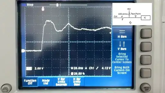

Pic 1 is of 100 ohms in series on the PWB side. As you can see the spike on the 5V clock signal dropped from 12V to 9V, but is still way too high. Larger series resistance such as 200 ohms had little further effect. Pic 1 - 100 ohms in series

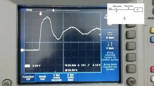

Pic 2 is of 100 ohms/1nf filter on the PWB side. I miss spoke when I said there was no difference. The spike drops in voltage but is still there right at the beginning. This is not a workable solution because my clock is unusable now. Pic 2 - 100 ohm / 1nF cap

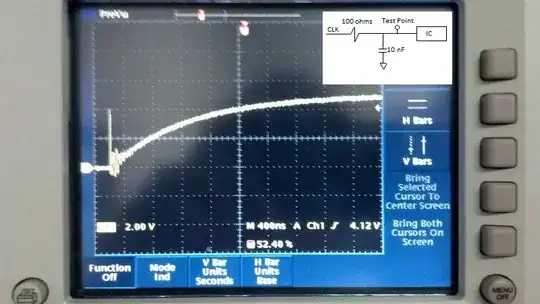

Pic 3 is of the 100 ohm/10 nf filter on the PWB side. The spike is still there and has not dropped in value. Pic 3 - 100 ohm / 10nF cap
Pic 4 is of the 'good enough' solution. I've added a diode to the 5V rail to dissipate the spike into the rail. (At the moment, I'm using a 1N4001 which is really slow, but it's all I had on hand. I plan on swapping that out with a 1N4148 which is much faster as soon as I get some.) As you can see, the spike is 7V and the undershoot only drops to 4V which is well above the 3.5V minimum high signal. Again, this will get me there, but if anyone has any other comments, I'd love to read them. enter image description here
