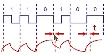

SPDIF embeds the clock into the signal, so it must be recovered. This is done with a PLL synchronized with the incoming SPDIF transitions. The amount of jitter in the recovered clock depends on how much jitter is in the incoming signal transitions, and the ability of the PLL to reject it.
When a digital signal transitions, the important moment occurs when it passes through the logic level threshold of the receiver. At this point, the amount of jitter added is equal to the noise (or amount of error added into the signal) divided by the signal slew rate.
For example if a signal has a risetime of 10ns/V, and we add 10mV noise, this will shift the logic level transition in time by 100ps.
TOSLINK receivers have a lot more random noise than what would be added by a coax (the photodiode signal is weak and must be amplified), but this isn't the main cause. It is actually band-limiting.
Coax SPDIF is usually AC-coupled with a cap or transformer-coupled. This adds a high-pass on top of the natural low-pass nature of any transmission medium. The result is a bandpass filter. If the pass band isn't large enough, this means past signal values will influence current values. See fig.5 in this article. Or here:
Longer periods of constant levels (1 or 0) will influence the levels on the next bits and move the transitions around in time. This adds data-dependent jitter. Both the high-pass and low-pass sides matter.
Optical adds more jitter because its noise is higher, and its passband is smaller than a properly implemented coax. For example, see this link. Jitter on 192k is very high (almost 1/3 of a bit time) but jitter on 48k is much lower, because the receiver doesn't have enough bandwidth for the 192k signal, so it acts as a lowpass, and the previous bits smear into the current bit (that's intersymbol interference). This is almost invisible on 48k because receiver bandwidth is sufficient for this sample rate, so intersymbol interference is much lower. I'm not sure the receiver used by this guy actually supports 192k, the waveform really looks bad and I doubt the decoder chip would find it palatable. But this illustrates bandwidth vs intersymbol interference well.
