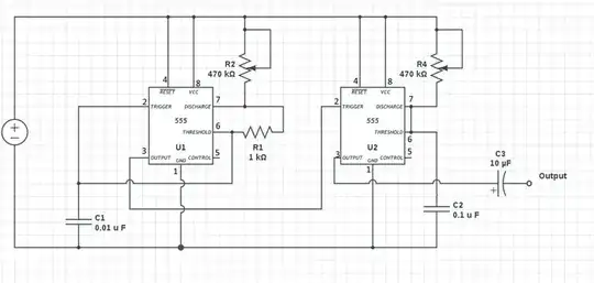

If you want something where you can easily change the sound, I recommend the Atari Punk synthesizer, as published in Radio Shack's Engineer's Notebook, by Forrest Mims. enter image description here
It certainly wouldn't qualify as "simplest", but it is the simplest circuit that can produce something approaching music. It's also a 1-IC circuit if you use the dual timer 556 package, instead of two 555's.
