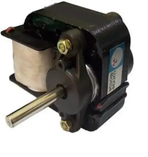

I'm a beginner in this field so please forgive me if I'm confusing with my question.
There is a component that I can't understand with Ohm's law which is a washing machine drain pump. Washing machine drain pumps from most manufacturers have similar specifications. Their winding resistance is usually between 10-20 Ω and it operates under 120 VAC.
From drain pump troubleshooting
Drain pump resistance
Drain pump specification
However the specifications written on the label are quite different. 120 VAC, 1.1 A, and 80 W.
Drain pump current draw
The actual current draw, 0.9 A, is close to the specification value which is 1.1 A.
I really don't understand that according to Ohm's law the resistance value calculated per the specification should be (R = U/I) 133.33 Ω where U is 120 V and I is 1.1 A.
But why is the winding giving me 14.8 Ω?
Shouldn't it draw 8.11 A as I = U / R = 120 V / 14.8 Ω = 8.11 A?

  • This is either an induction motor (should be of the shaded pole type but this feature was not visible on the pole pieces and I think is required for self starting and direction selection) or more likely a permanent magnet AC motor that can start in either direction. The impeller looks reversible so no information there. If the motor turns under power it is likely to be working. It may wear faster if not water lubricated. Take care with mains voltages. – KalleMP Mar 23 '18 at 23:20

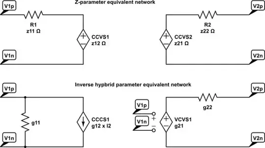

Have you ever played around with an electric motor connected to something like a light bulb or another motor? If you spin the motor, the motor acts like a generator and spins the other motor or lights the light bulb. The same thing happens when the motor is spinning under electrical power, the motor will behave like a generator, looking something like this:
Notice how although you see 12V across the motor, the motor resistance only sees 1V, making the current through the motor 100mA instead of 1.2A. This phenomenon is called Back-EMF, and is the reason why motors will draw a huge current on startup, but not much when running normally (when you turn on your vacuum the lights dim for an instant).

    This. The coil will have inductance too, but this, not inductance, is the main reason for the low current draw. Stall the motor and it'll still have inductance but the current draw will be MUCH higher. (Actually, don't do that...) –  Mar 23 '18 at 14:52
  • +1 for mentioning back EMF. I failed to mention that in my answer – DerStrom8 Mar 23 '18 at 15:21
    This experiment will not translate directly to the AC type pump motor in question but makes some sense of what is happening. – KalleMP Mar 23 '18 at 23:06
