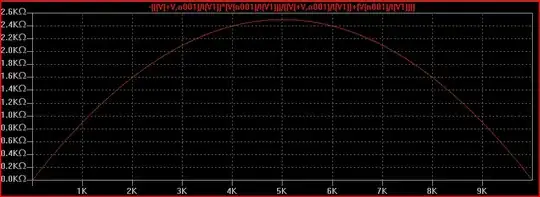

Here is a simulation of a 10k pot being swept from one end to the other:
Pot Sim
The X axis represents the rotation from 0 to 100% (ignore the actual values shown) The Y axis is the output impedance measured at the wiper. We can see how it starts and ends at 0 ohms and peaks at 2.5kOhms at the middle (50%)
This is comfortably less than the recommended source impedance of 10k.
So, you could use any pot value between e.g. 100 ohms and 40k as your voltage divider.
