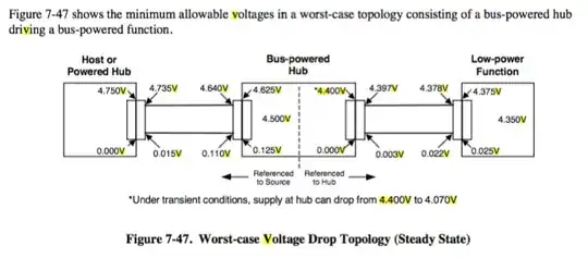

  • @endolith The 4.4V is talking about the voltage an unpowered hub is allowed to have on its ports, and the true minimum you need to design an unpowered peripheral to accommodate is 4.35V. The voltage minimum for a USB host is 4.75V. A bus powered perihperal does not and often is not connected directly to a host port, so what voltage you measure at a USB host couldn't be less relevant to this discussion. – metacollin Aug 23 '16 at 13:43

What is relevant is that is not really about the current. It's about charge, so you're already sort of on the right path with this. Specifically, it is about the voltage droop. An upstream port on a hub must have no less than 120µF of very low ESR capacitance on its output VBUS, the bus powering downstream peripherals.
A host or powered hub yielding the worst case output voltage (4.75V), going through the crappiest connectors, the crappiest cable, to an unpowered hub that also uses the crappiest connectors, then that hub further has the crappiest VBUS input voltage to VBUS output/downstream voltage drop (350mV), the voltage will be 4.4V. That 4.4V, connected through crappy connectors to a crappy peripheral can cause it to see the real absolute minimum voltage for a low-power device: 4.35V. From page 175 of the USB 2.0 spec:
Let's do some math. an unpowered upstream hub must have 120µF of downstream capacitance. At 4.4V*120µF, that's 528µC of charge. A device connected has a 10µF capacitor. If you pretend that there is no static load or power, just a charged capacitor on the port, and an uncharged 10µF one in the peripheral, charge will be distributed not until the other is full, but until the voltage between them is equal. Charge is conserved, so the point at which the two capacitors voltages will equal each other, given 528µC of starting charge, is roughly 4.06V. Or, 40.6µC transferred. Add in the connector resistances, and the downstream capacitor will not even be able to draw that much charge during inrush.
So, literally the only important factor is that it does not exceed 10µF. Current is not really the thing that matters, its how depleted the hub's downstream port capacitance can be depleted without drooping more than 330mV during the transient before things like cable inductance give time for the actual host power to catch up. And a 10µF capacitor is the closest available value that won't do that.
Also note that there is no capacitance limit. You can have 1F of all ceramic capacitance on a downstream device, as long as you have it divided into 10µF sections, and only one of which will connect on attachment. Once the device is attached, you must stay below any 10µF step, but you may gradually "online" more capacitance in 10µF increments. The whole point is avoiding that transient.
And yes, this means a low-power peripheral is not only supposed to work down to 4.35V, but also withstand a 330mV voltage droop transient, such as when something new is connected to a hub. This also means that, theoretically, if you plugged in two devices at JUST the right times so as to be nearly simultaneous, you could possibly disrupt operation of other devices on the unpowered hub. I'm sure the robots, with their HPETs, will exploit this critical flaw in our USB bus specification to bring about our downfall.
