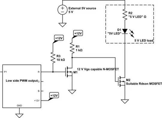

If you can "inject" 5 V from a separate source, you can build your own low-side PWM like this:
EDIT: New schematic due to lowside PWM from your driver. This is kind of dirty. If you want to improve the efficiency and probably dimming at very low duty-cycles, you should consider an inverting gate driver instead of R1 and M1.

  • @OllyThomas You're welcome but hold your horses. If your 12 V PWM output isn't a true 12 V driver but rather another low side PWM, you will need pull-up instead of pull-down. If you have a wireing diagram for it it would be easy to determine. – winny Mar 20 '18 at 08:26
  • Hi Winny, Not been shopping yet! This is the controller I am using: https://www.ultraleds.co.uk/px24500a-3-channel-x-6a-dmx-controller-constant-voltage.html and this is the spec sheet for it: https://www.ultraleds.co.uk/fileuploader/download/download/?d=0&file=custom%2Fupload%2FFile-1387546228.pdf Do appreciate you taking the time to look at this for me! Olly. – Olly Thomas Mar 20 '18 at 13:59
  • Ah! As I expected! Not a true 12 V output but rather low side PWM. I'll update the schematic for you to reflect this. – winny Mar 20 '18 at 14:48
