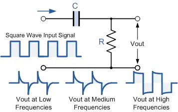

The top trace is a perfect output for a differentiated square-wave:
The \$C\$ is your coupling capacitor. This is a high-pass filter with
\$ f_c = \dfrac{1}{2 \pi RC}\$
So the higher RC the lower the cutoff frequency. If \$f_c\$ is lower than the signal frequency the signal will pass without much distortion, that's the rightmost waveform. As RC becomes lower the cutoff frequency will move to the right, and ultimately only the signal's highest frequency components will pass the filter. That's the leftmost waveform, only the edges will pass.
So to get a good reconstruction of your signal you'll have to increase RC. I'm not quite sure where exactly you measured this signal, so I don't know the components' values, but you may increase \$R\$ by a factor 10 to start with.

  • Oh those http://www.electronics-tutorials.ws images are just great – m.Alin Jul 26 '12 at 15:07
  • @m.Alin - Sure they are! :-) Not just their images, BTW, though the site has a few errors here and there. – stevenvh Jul 26 '12 at 15:09

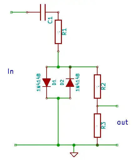

This is my idea in one of the comments elsewhere. The idea is to use the clipping characteristic of the diodes to shape the input signal to nice clean pulses. R1, D1 and D2 form a pulse shaper at +/- 600mV. Regardless the input voltage, the voltage at the diodes will not rise above +/- 600mV.
C1 removes the DC component in the signal.
The voltage divider at the right then changes the voltage to the required input voltage of the recording device. From the other question I understood iPhone input level is about 6mV, so the 600mV at the diodes is reduced by a factor 100 using R2 and R3.
Diodes in my opinion can be 1N4148, but the resistors and the capacitors are entirely up to the applied voltages. I think an input impedance of 10 - 50kΩ should be just fine, and output impedance should be relatively low. Guessing output voltage at approx 6mV then:
  • C = 100nF
  • R1 = 22kΩ
  • D1 = D2 = 1N4148
  • R2 = 47kΩ
  • R3 = 470Ω
pulseShaper

  • That looks remarkably similar to the input circuit used by the Microbee when reading cassettes back in (see link in question). I don't really understand how these two diodes work in that arrangement though. Is there a name for that type of circuit that I can read up on? – Brad Robinson Jul 27 '12 at 03:59
  • Mind you the values for the various components are guesstimates as exact in- and output specifications are unknown to me. I don't expect them to be very far off though. – jippie Jul 27 '12 at 06:21
  • @Brad - The diodes clip the signal to + and - 0.7 V. The resistor divider R2/R3 will scale this down to lower limits. – stevenvh Jul 27 '12 at 06:22
