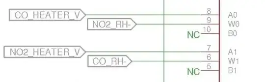

I'm using Microchip TC1071 in a circuit to provide an adjustable output voltage (appears to be pin compatible with LT1761-SD). My plan is to use a digital potentiometer (Microchip MCP4251) to control the output voltage within over some range. The schematics and layout are on solder pad here. The adjustable regulator circuits are in the upper left quadrant of both the schematics and layout.
I've got it all hooked up per their typical application circuit and it doesn't seem to work the way I'd expected it to. I have an 0805 100nF ceramic capacitor near the input voltage (pin 1) of the regulator. I put this 10uF electrolytic capacitor near the output voltage (pin 5). The high side of the voltage divider is connected to my digital potentiometer. The low side is connected to a 56 kOhm 0805 resistor. The \$\mathrm{\overline{SHDN}}\$ (pin 3) measures 5V as does the input voltage.
So I blew the digital potentiometer off the board and hooked up a fixed 47kOhm resistor. If I read the datasheet correctly, the voltage I should get out of the regulator in this configuration is {1.2 * [( 47 / 56 ) + 1]} = 2.21V. Instead, I measure about 1.6V. I'm staring at this datasheet and am somewhat baffled. Are my capacitors inappropriate to support this regulator (seems like there are some ESR requirements, but I can't tell what the ESR of my caps is)? They suggest using somewhat larger resistors for the voltage divider:

Once I resolved the netlist error with some trace cuts and softwires, I was able to control the voltage as I had intended per the design.

It looks to me like a netlist/layout error:
schematic screenshot
If you are placing your fixed resistor on the dig pot footprint, it would also be messed up. Looks like you accidentally wired the CO+ and NO2- together and the NO2+ and CO- together so the LDO(Vout-Vadj) is not across a resistance as you believe.

  • Wow, that is an amazing catch. Thank, I'll have to get the exacto knife and soft wires out and see if uncrossing these wires gets it running properly. Will report back. – vicatcu Jul 22 '12 at 21:49
  • :) have had a few similar mistakes in my past – justing Jul 22 '12 at 22:11

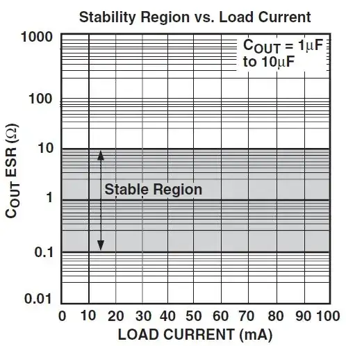

Do you have a chance to check the output with an oscilloscope? It is possible that your LDO runs unstable. The reason might have to do with your output capacitor's ESR. Please look at page 6 of the datasheet. This LDO (like many others) is only stable when the output capacitor's ESR is in a certain range:
LDO - ESR Tunnel of Death
Some call this region between the lower and upper limits for the ESR the LDO's tunnel of death. While adding a low-ESR ceramic capacitor is often a good idea, it may be bad here.
Related: Choosing a Tantalum based on Min. ESR - LDO Stability
Also: One thing I would worry about with a digital pot between Vout and Ref of an LDO is the digipot's default value after power up, before it is told what to do. It might happen that you get an undesired, and, depending on the load, potentially harmful output voltage before the whole thing gets into proper regulation.

  • I sized the low side resistor so that when the Digit-pot powers up to mid-scale it sets the LDO to about the right voltage... – vicatcu Jul 22 '12 at 18:31

Inappropriate ESR would cause the regulator to oscillate, which sometimes causes a DC reading to look incorrect if you're measuring it with a multimeter. It shouldn't cause a DC setpoint error. Do you have the ability to scope the rail?

  • it didn't blow off the board, I hot-air blew it off to remove it as a variable... – vicatcu Jul 22 '12 at 04:58
  • yes i will scope the rail next chance I get (probably monday) – vicatcu Jul 22 '12 at 04:59
  • I linked the capacitor manufacturer specs, do you see an ESR in there anywhere? I didn't... – vicatcu Jul 22 '12 at 05:33
  • It actually is, in a manner of speaking. The [loss tangent](http://en.wikipedia.org/wiki/Loss_tangent) is the ratio of ESR to capacitive reactance, and is usually expressed in percent. 0.2% = ESR / |Xc| (at 120Hz) so the ESR should be around 265 milliohms. – Adam Lawrence Jul 23 '12 at 21:16

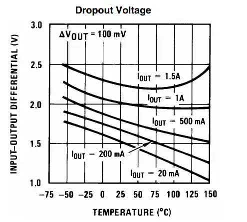

If you do not need LDO the LM317 is certainly reliable. Yes the LDO is also low current making it very high impedance so bias resistors of 47KΩ are no good. I do not understand why you did not choose within the range of 470KΩ and 3MΩ as directed. Yes it is that sensitive. LM317 is not so fussy since it is not that high Ω or low drop out.. but 2.5V drop or so from Vin to max Vout. Ok here. they use 2.50 Vref.
BTW the OEM cap specs ought to indicate ESR. If too low it cannot remain stable since voltage feedback loop gain is delayed due to low R ratio. Too high and you get excess ripple. You can measure with any 50Ω sig gen... Use 1 Ω series R and measure voltage drop where voltage is equal between R and cap and then compute impedance at that freq. many other methods...using fixed F & measure R ratio of 1 Ω and Cap ESR. Choose series resistor near expected ESR for best sensitivity.

    He says he uses 5 V in. The LM317 is specified for a minimum input-output difference of 3 V. Minimum out is 1.25 V. So the LM317 will give vicatcu only a 0.75 V range. Not good. – stevenvh Jul 22 '12 at 10:44
  • THat is incorrect and might only come close to a 3V drop at 2A if that were even possible. – Tony Stewart EE75 Jul 22 '12 at 10:52
    I'm looking at the TI datasheet. (If you have another one you should add a link in your answer.) Recommended operating conditions: 3 V difference minimum. Line regulation and reference voltage are specified for this 3 V difference. That means that you *cannot* rely on the reference voltage being between 1.20 V and 1.30 V if you don't respect that. Then anything is possible. – stevenvh Jul 22 '12 at 11:04
